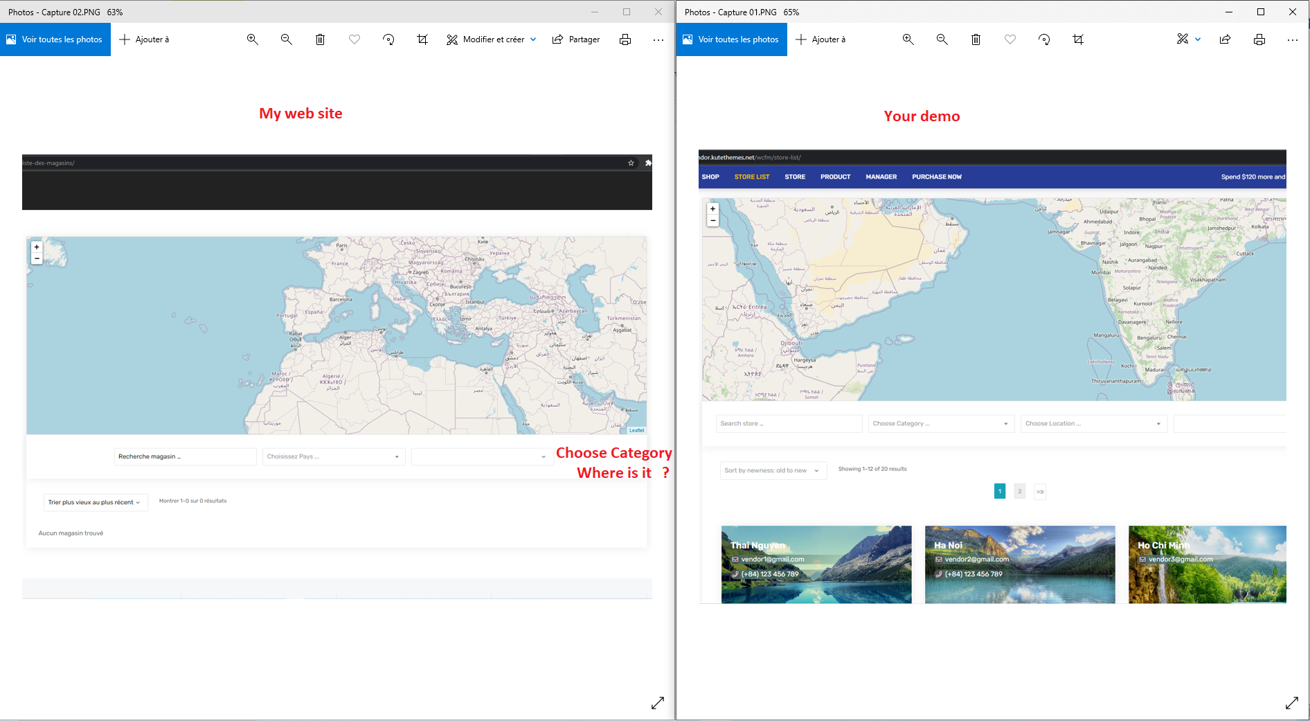

    1) When we click in STORE LIST we don't see as a choice Choose Category look in the demo of dukamarket and you will see compared to me what is missing you have used which shortcode to add please ?
    why for me Choose Category is not displayed

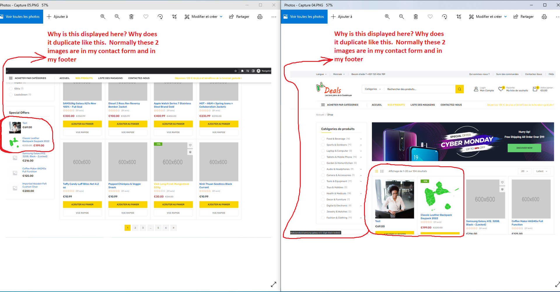

    2) The image that is in contact us and my map of Guadeloupe that is in my footer appears in the widget (Special Offers) and in the menu (Our Products) Is this normal ?

    Posted by: richi_2020, Oct 26, 2022 at 23:31 (2 year ago)
    1) See capture 03
    Posted by: richi_2020, Oct 26, 2022 at 23:34 (2 year ago)
    2) See capture 06
    Posted by: yame, Oct 27, 2022 at 08:01 (2 year ago)
    Thanks.
    1. My coder will help you to check it
    2. I check the Footer, it's an image: https://prnt.sc/2uDDdx0FI-Rg
    And in the Special Offers section, this is a product and you upload this image to be the product image: https://prnt.sc/NpdrbDlBnrUK
    Two of these sections are not related to each other.

    2. Since two of these sections are not related to each other then why does it make it duplicate ?

    1. It is because you still do not have any categories so it does not have the filter.
    2. These are unrelated things. One is a product, and the other is an image. I think you got a mistake during the building of your site process. It cannot be duplicated for these parts.

    2. A friend told me to change the product images, but do you think that after that the problem will return ?

    2. I don't think it related to each other. If not, you can change this product image again and check it.

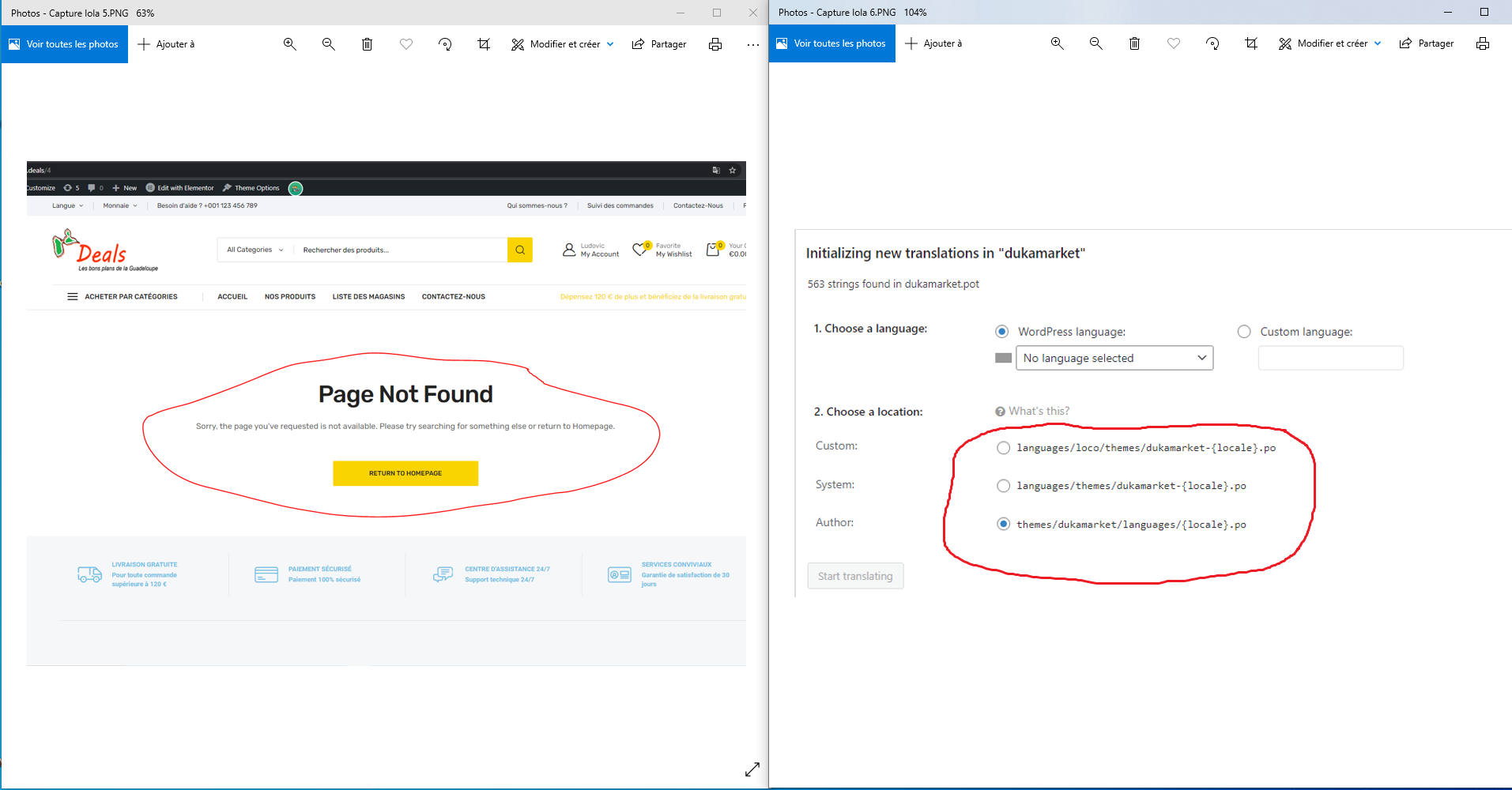

    Posted by: richi_2020, Nov 15, 2022 at 03:34 (2 year ago)
    I wanted to ask you when you want to translate what you choose ?
    I'm attaching a screenshot of what I've already translated but strangely enough, the translation doesn't always take effect .
    Which one should we choose to do the translation with loco translate ?
    Custom: languages/loco/themes/dukamarket-{locale}.po
    System: languages/themes/dukamarket-{locale}.po
    Author: themes/dukamarket/languages/{locale}.po

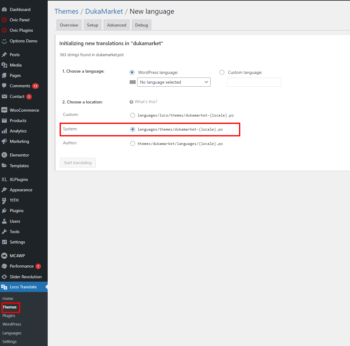

    Posted by: yame, Nov 15, 2022 at 08:57 (2 year ago)
    You should select the location is System. It will save all your changes.
    If you need help, please provide the admin account, I will help you to check your site

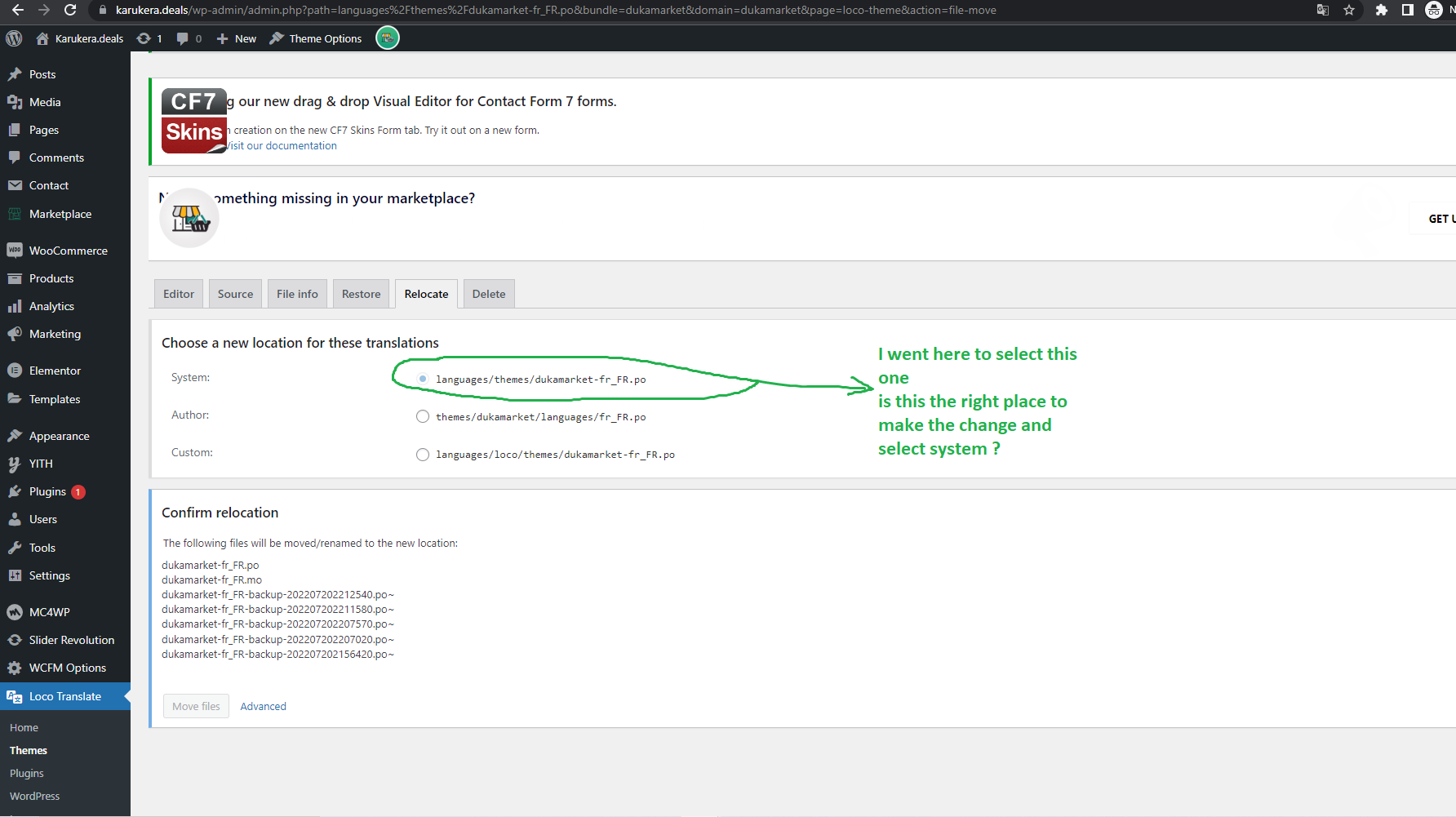

    Posted by: richi_2020, Nov 15, 2022 at 16:49 (2 year ago)
    Hello to move the files that is to say to modify my error that is to say to select system.
    Tell me you have to go to Relocate then choose system then click on Move files.
    I join you a capture so that you see what I made tell me if it is good ?
    Posted by: yame, Nov 16, 2022 at 02:03 (2 year ago)
    It's quite weird in your screenshot when you use the plugin Loco.
    This is the Loco translate plugin on my site. You can see it.
    If you need help, you can provide the admin account then I will help you to translate.

    Posted by: yame, Nov 24, 2022 at 01:34 (2 year ago)
    Thanks. I was off yesterday for my own business.
    I also checked your site and I see that you selected the correct position: https://prnt.sc/CQ4r3ro3aetB
    The last screenshot might be taken when you did not activate my theme so it was quite different.
    Now you can translate in the System to translate all the texts you want. If you need help, please let me know.

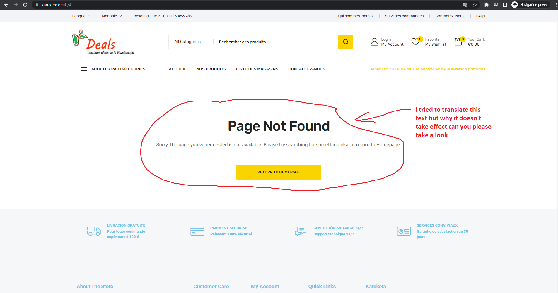

    Posted by: richi_2020, Nov 25, 2022 at 01:47 (2 year ago)
    I tried to translate this text but why it doesn't take effect can you please take a look
    Posted by: yame, Nov 25, 2022 at 08:41 (2 year ago)
    DONE: https://prnt.sc/68AUSyMt5A4D
    Because you have to select the language is EN, not FR.
