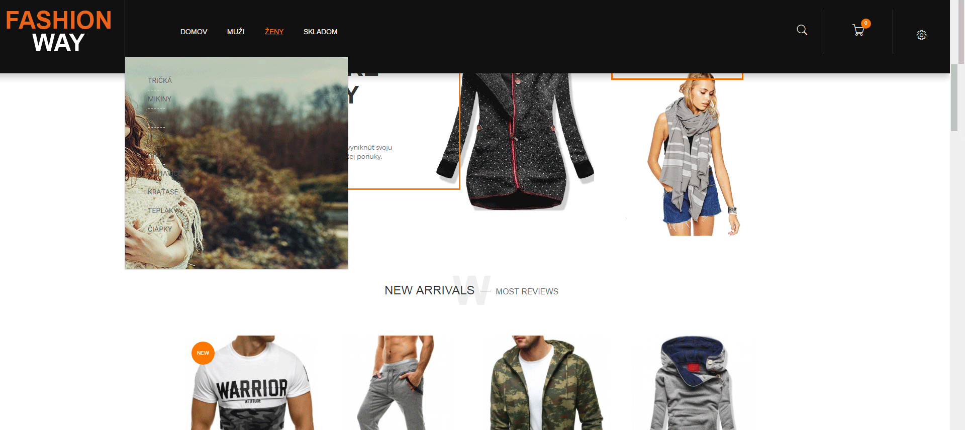

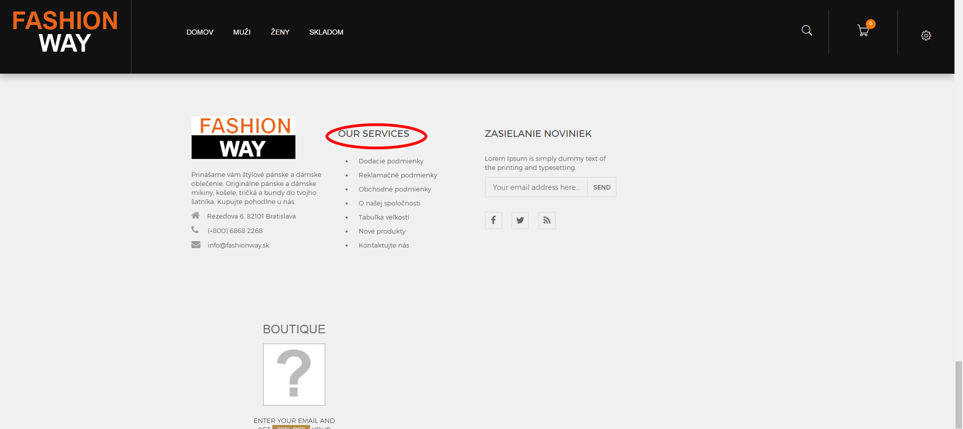

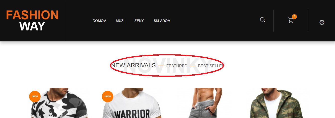

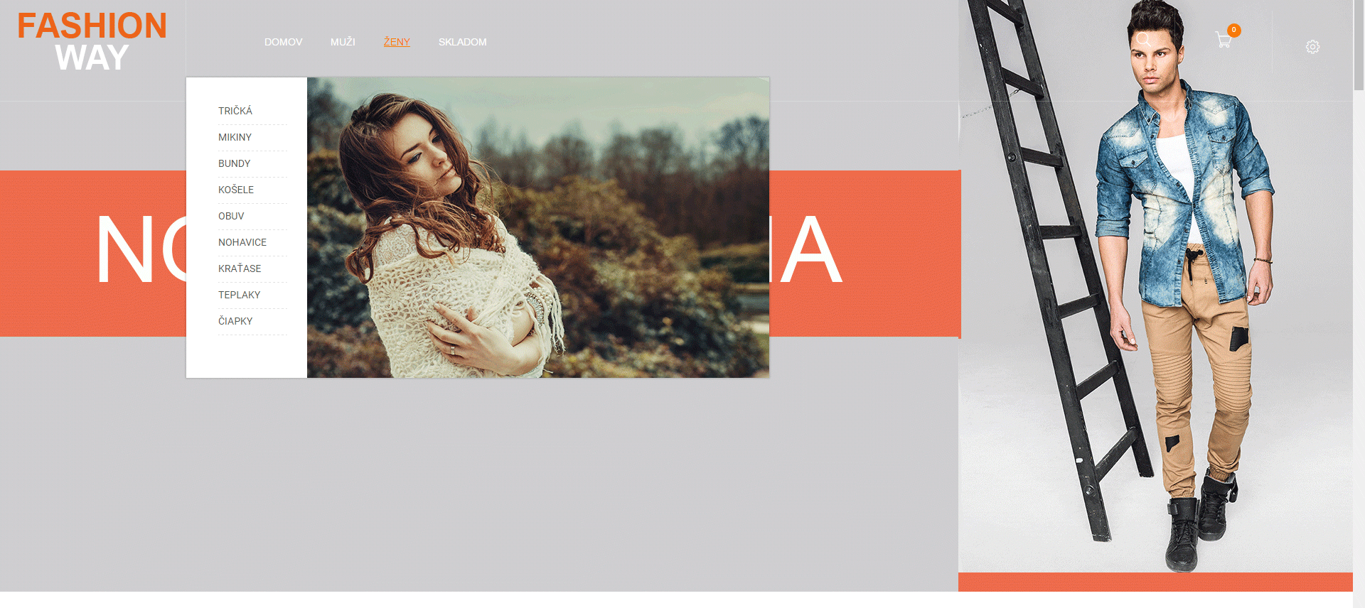

    HI Yame
    I found another problem on my site. If I click on the page at the top of the menu it looks normal( see attachment number 1) But when I scroll down the page and click on menu it looks like atachment number 2. It happens only on some web browsers for example google chrome. Could you tell your coder about these problems too. And also I tried to translate megacategory module but it doesnt work see atachmnent number 3. And also i have problem to translate one word from footer see atachment number 4. Would you help me please how to translate these wordds ? Thank you .

    Posted by: yame, Apr 24, 2017 at 01:33 (8 year ago)

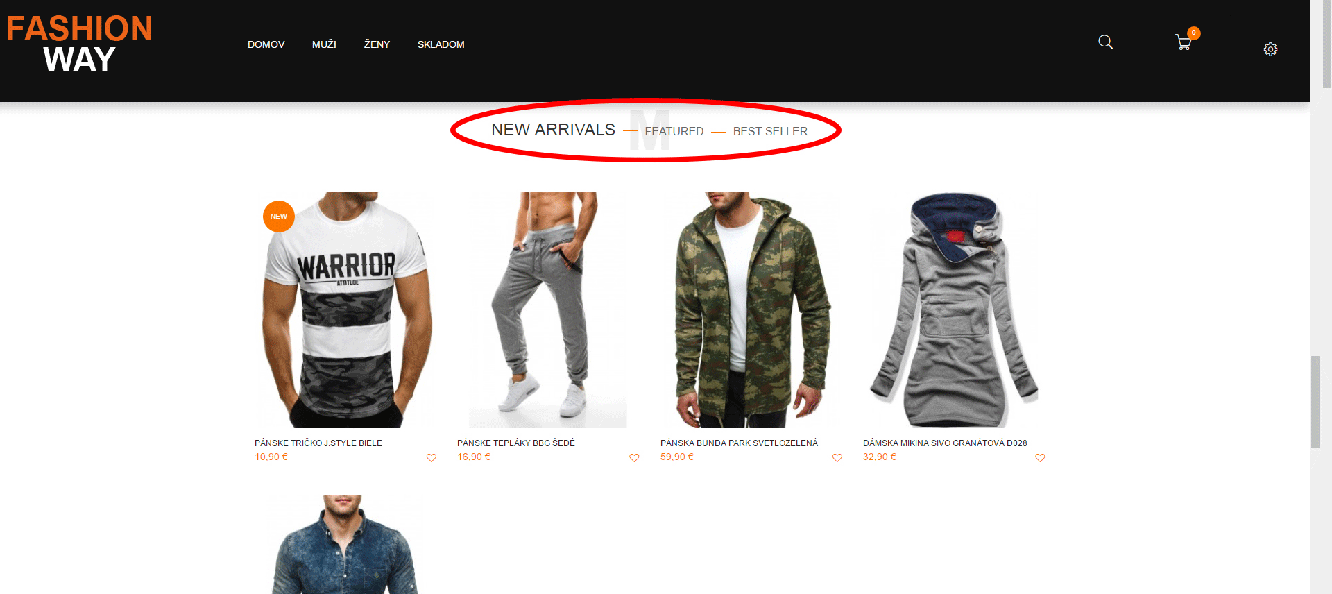

    1 - Problem with menu banner: OK mate, my coder will check
    2- Translate category module: You can go to Mega category module > select the position of place that you want to translate then change into your language for each GROUPS OF WIDGET (see my attachment 1)
    3 - "Our services" text: you can translate in Localization > Translations > Select translation in Installed module and then find Module blockcms. The text will be there

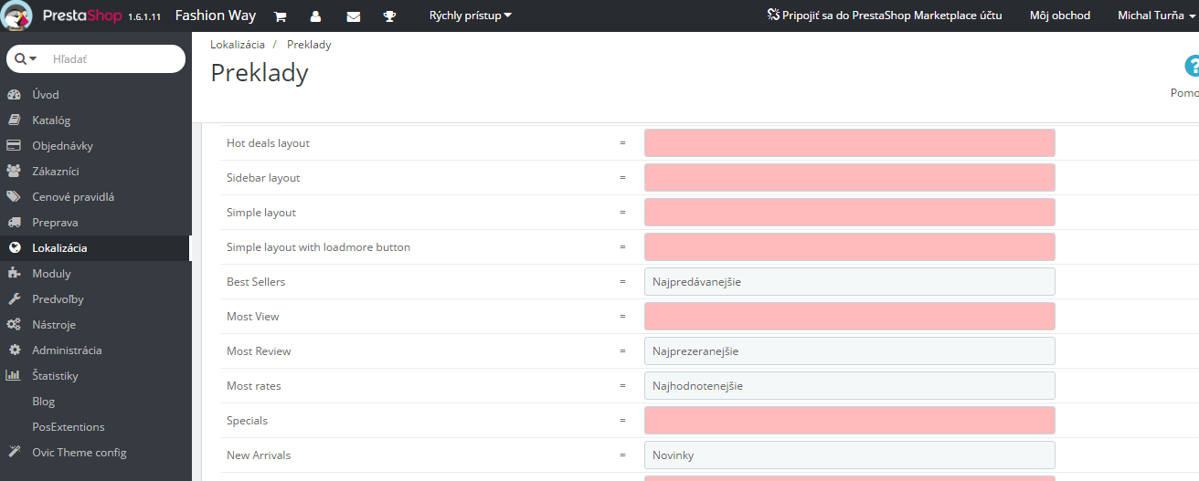

    Posted by: mickeyt27, Apr 24, 2017 at 14:23 (8 year ago)
    So i tried to translate category module but there i can only translate backround text see atachment. I tried also to translate in Localization > Translations >megacategory module but changes i cant see on my site see atachment 2. I also tried to translate Our Services text but in module blockcms i dint find our services text, is missing there.
    Michal
    Posted by: yame, Apr 25, 2017 at 02:30 (8 year ago)
    Dear mate
    I send you 2 screenshots
    - I still can change the text on category (NEW ARRIVES => TEST). You can provide me the texts that you want to translate and I will do it for you
    - I see that your text was changed already.

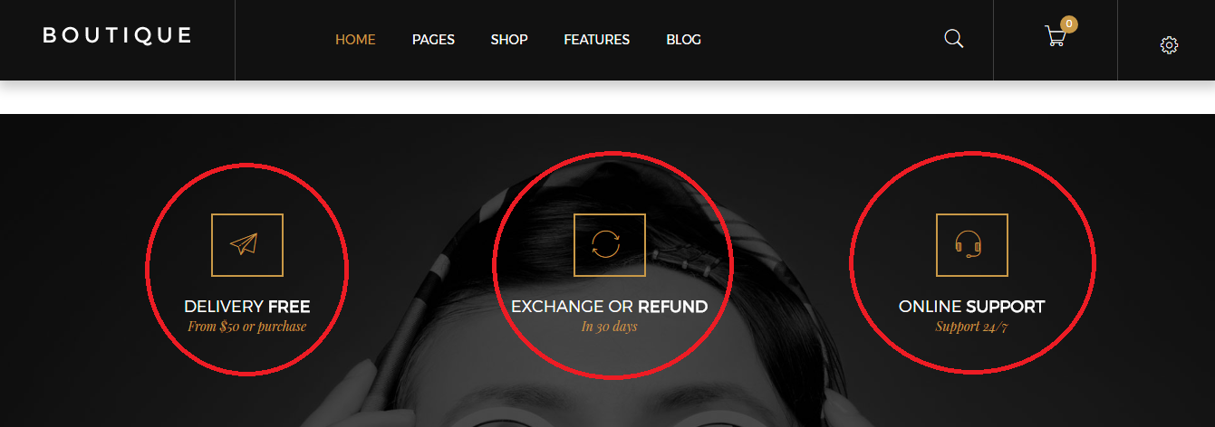

    Posted by: mickeyt27, Apr 25, 2017 at 12:20 (8 year ago)

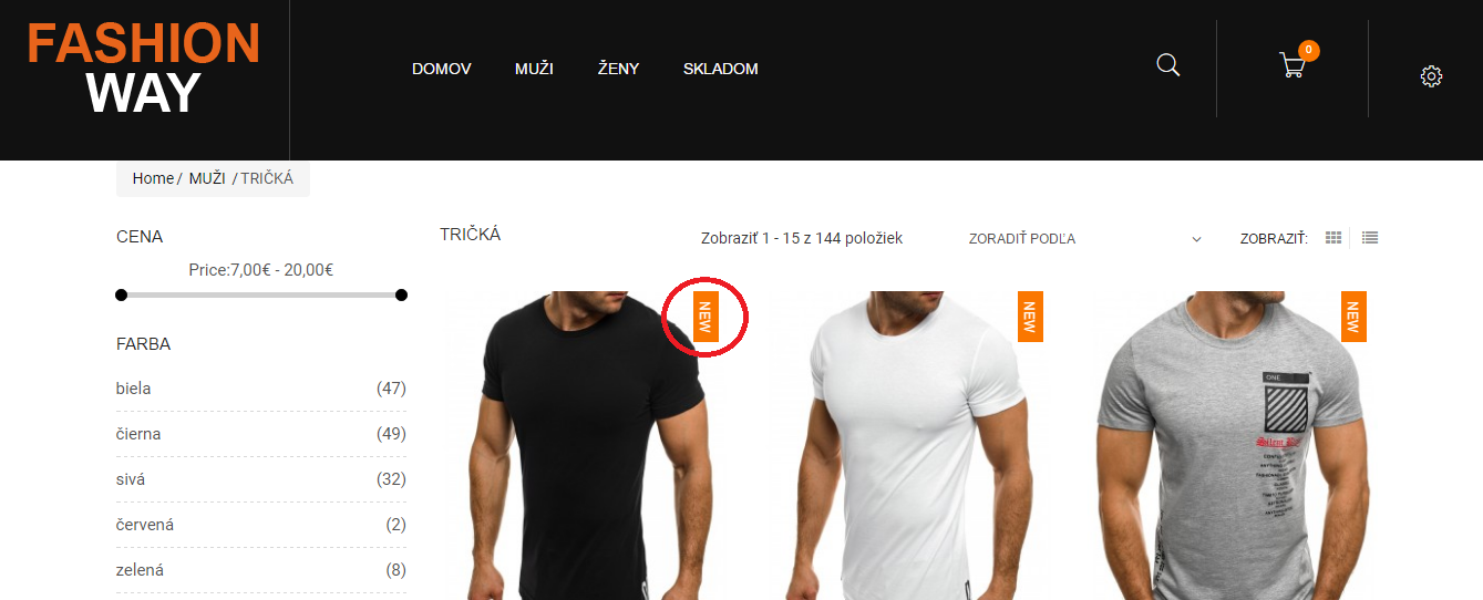

    Thank you Yame. I translated it finally. Would you also help me to translate label "new" on product page ? (see atachment 1). Please could you help me to add aspects (text and pictures) to Ovic - paralax block dispayed Home top content see atachment 2. Many thaks for your advices.
    Michal
    Posted by: yame, Apr 26, 2017 at 01:53 (8 year ago)
    1 - Translate label NEW: This issue was updated in the latest version (1.0.6). Pls update your site to solve this (you can follow the change log here: http://kute-themes.com/prestashop/boutique/changelog_boutique.txt ). REMEMBER to BACKUP both your database + source code before updating
    2 - add aspects (text and pictures) to Ovic - paralax block: DONE
    3 - scroll down the page and click on menu: You have to disable CCC JS in backend. See attachment
