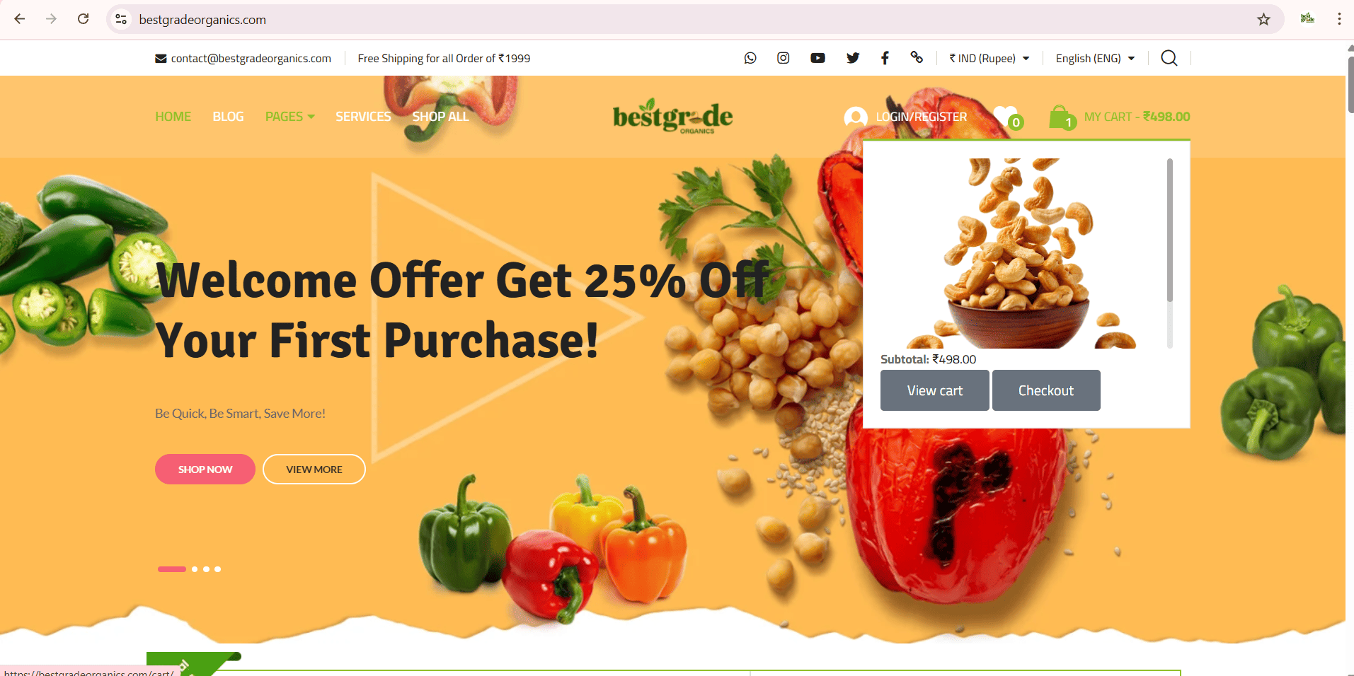

    I’m writing to raise a serious concern regarding recurring issues I’ve been facing with your theme on my website. Despite previous fixes, the same problems keep returning, and new ones are emerging as well. Below are the details:
    Cart Dropdown CSS – The dropdown style is broken again and not consistent with the default theme design.
    Wishlist Page Icons – Default icons are not loading or appearing properly.
    Cart Page – Layout and some features are misaligned or not functioning as expected.
    Header Issues – We’ve already faced problems with the header styling and functionality, and they’re recurring.
    Theme Compatibility – The theme does not appear to be updated for the latest version of WooCommerce, causing additional compatibility issues.

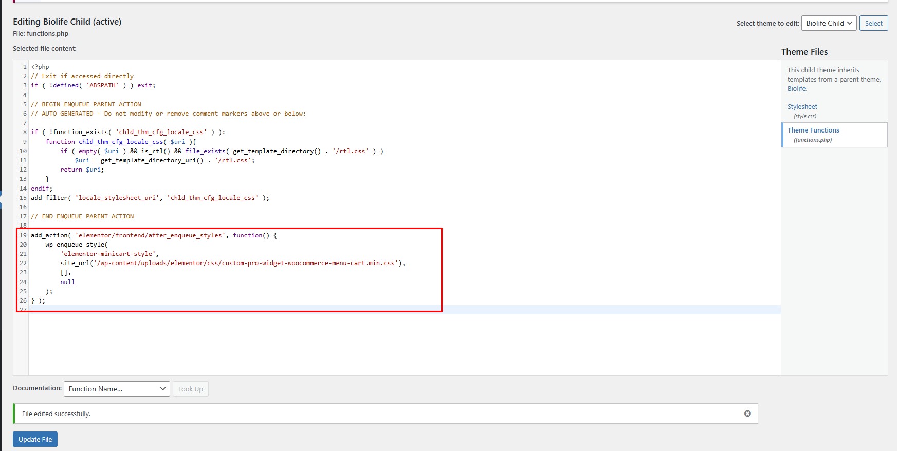

    This problem comes from Elementor Pro, this plugin has overwritten the default minicart code, the HTML has been changed but the CSS file corresponding to the new HTML has not been called (https://bestgradeorganics.com/wp-content/uploads/elementor/css/custom-pro-widget-woocommerce-menu-cart.min.css).
    I tried to find it but couldn't find it, maybe you have enabled the minicart editing feature from Elementor Pro or there is an error from this plugin itself that causes the HTML and CSS to not be called correctly.
    There is a way to fix it by using a child-theme and adding code to fix it (screenshot_1), but for a more thorough solution, please contact Elementor Pro for a solution.
