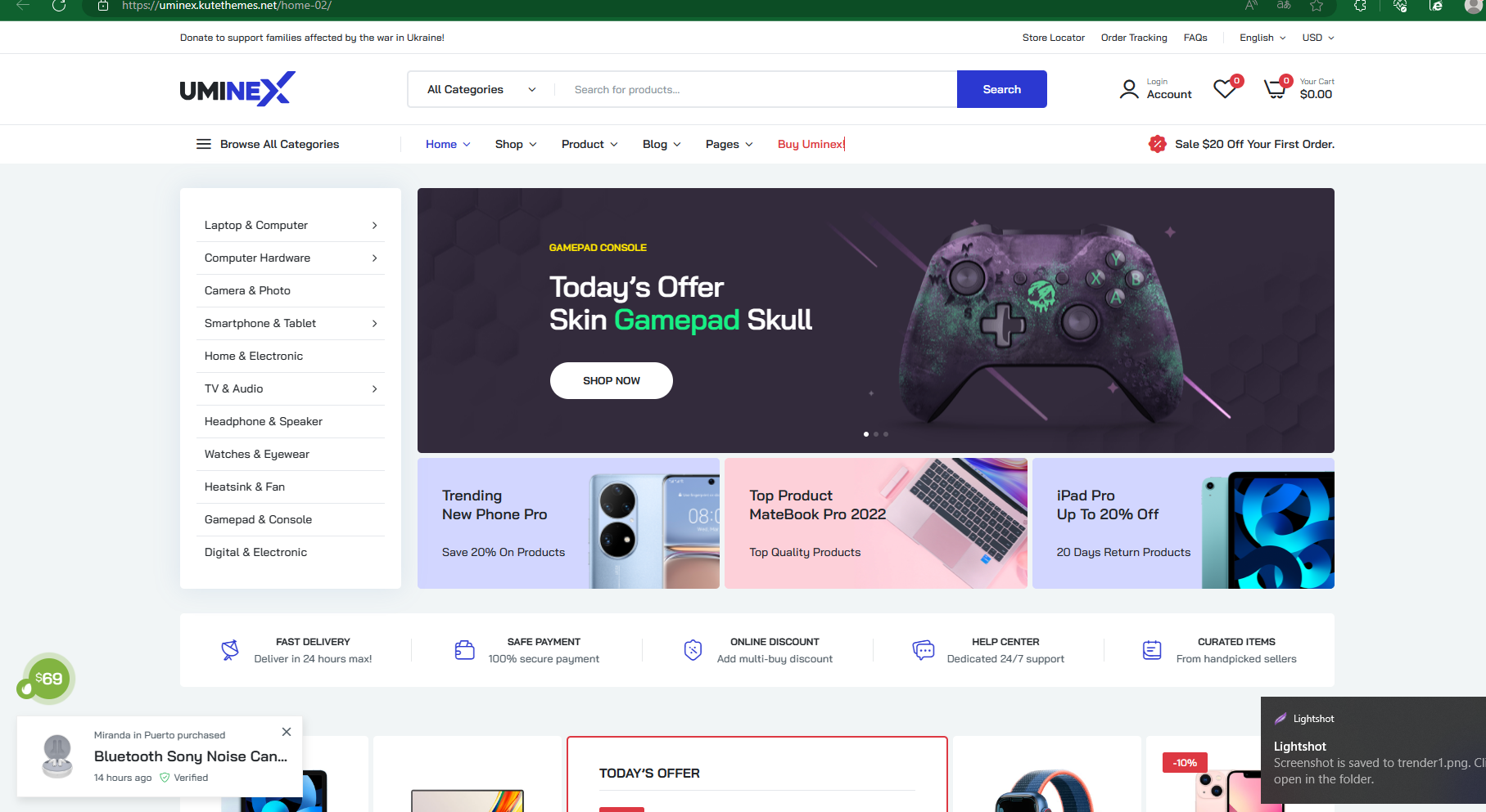

    Hello! in first screenshot you can see how template should be and in second my template sizes are smaller then original one, cant udnerstand when and how its happened..
    + when i click on category menu under logo its 24/7 showed up not dissapearing when i click to dissapear it.. + in primary menu not showing good icons only stock default icons showing you can see on my website https://trender.ge

    i make correct sizes on website,but still how can i fix category menu to make it dissapear when click on it? i want pop up menu when click on it ok?+ symbols and icons are not properly working on primary menu
