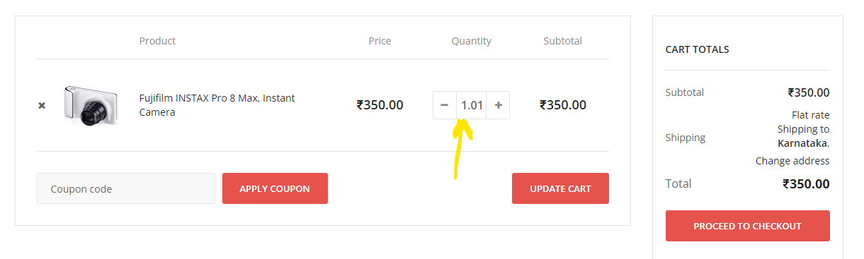

    if we increase the product quantity, its coming in decimals as shown in the image. how to disable that.? the increment should be in whole numbers.

    Hi @hitayulifestyle,
    My coder has checked your site, and he found out that this plugin caused this problem: "ATUM Inventory" : https://prnt.sc/8AdhgrOTKzKM
    This plugin customized again the step when clicking on the icon to raise or down quantity.
    So you have to check it again.
