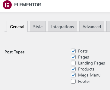

    After 4 hours of troubleshooting, I figured out that enabling the use of Elementor on the footer causes two separate popups to come up when you click an image.
    I created clean site with just your demo content to demonstrate: http://dukamarket.devpreviews.com/product/digital-blood-pressure-monitors/
    Click on the image to expand it, and you'll see that there are TWO popups.
    The screnshot shows the area where Elementor can be enabled on the Footer. However, without Elementor enabled on the footer... I can't actually edit the footer.

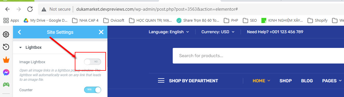

    The cause by Elementor Setting. I turned off the Image Lightbox option and it works now
    Please check your site again and let me know your results
    Posted by: pembo13, Nov 17, 2021 at 03:12 (3 year ago)
    Thanks, that fixes it.
