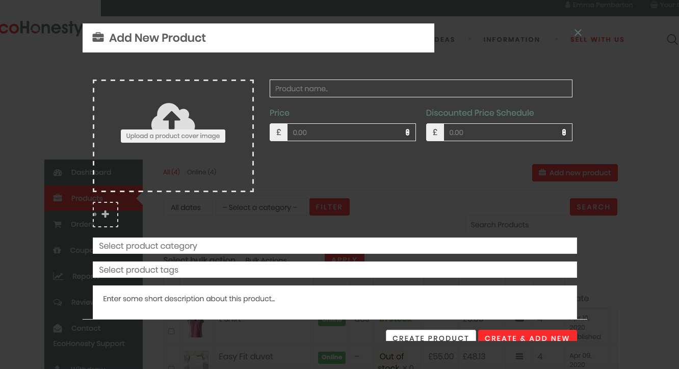

    Posted by: houndlounge, Apr 15, 2020 at 19:00 (5 year ago)
    Dear Yame,
    an old problem has now come back. The add product on vendor dashboard is now transparent again. It means I cannot upload products. Please see screenshot. You did originally fix this but it's now reverted back to original problem.
    It seems your theme is not compatible with Dokan which was whole reason I bought your theme.
    Please get your coder fix all of these problems as soon as you can or allow me to have a refund. I have wasted two whole weeks building my website using your theme and am very angry that there are all these faults with Dokan plugin.

    Posted by: yame, Apr 16, 2020 at 04:19 (5 year ago)
    I get the feedback:
    1. Do not show variable product: Because you did not enter the price for each variable product. Now it is showing: https://prnt.sc/s09gms
    2. DONE: https://prnt.sc/s09gzr
    3. Popup when creating a new product: My coder updated for you: https://prnt.sc/s09h74
    Pls check again all your issues then let me know
