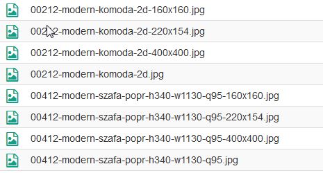

    Hello my friend,
    I want to discuss about image resize again because i finished my eshop and is ok with best quality and 4 image sizes but i have problem with GTMETRIX and home page slider photos on https://mamacity.gr.
    1. Fist of all i disabled your function because creates many resize images for each upload 27+ photos for each product
    2. My Image Sizes are : (Look the attachment )
    -160 x 160
    -220 x 154
    -400 x 400
    - and Basic photo size 700x700
    To succeed this i change your kt_setup() ( Look the code on attachments )
    - You will see that i add 3 lines on your code
    add_image_size ( 'thumbnail', 160, 160, true );
    add_image_size ( 'medium', 400, 400, true );
    add_image_size ( 'large', 700, 700, true );
    - The same settings on woocomerce image size (Look the code on attacments )
    Now i have this problem : The home page if you see on https://mamacity.gr load for slider products 700x700 images but
    the slider needs 272x272
    GTMETRIX says to resize 700x700 to 272x272 because homepage use the Catalog image for these and not the size 272x272.
    How now i can create and the new size 272x272?
    How to do your theme to load on homepage the size that i have 272x272 and not load the main photo 700x700 on slider products ?
    Last point i follow your instructions and didn't work but reduce the amount of images from 27+ to 10
    but too many and 10 photos from each product.
    Thank You and i wait your support
