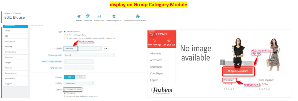

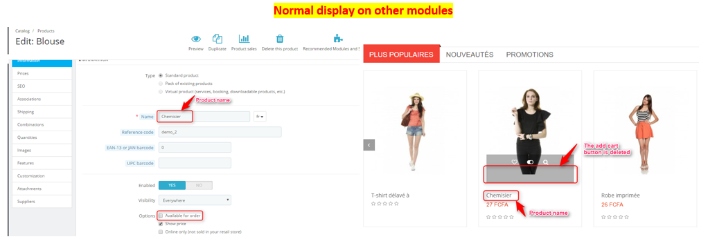

    Posted by: mga91, Feb 23, 2017 at 10:05 (8 year ago)
    Hello Yame
    First issue
    When I create product and click on "available for order" , normally the add cart button doesn't display. But on the Group Category Module the add cart button still displays itself.
    Please see screenshot for more details

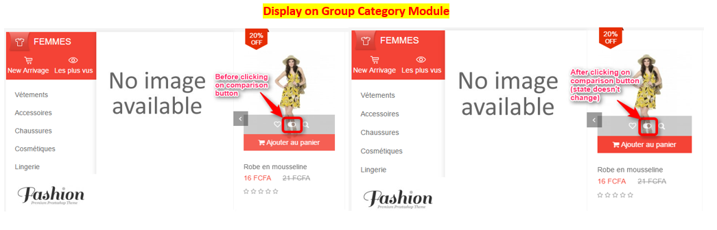

    Second issue

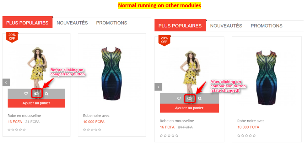

    I think you don't understand exactly the issue because on the others modules the comparison button runs correctly. I try to give more details and screenshots.
    On other modules when I click on the compare button its state changes but on the group category module the state does not change

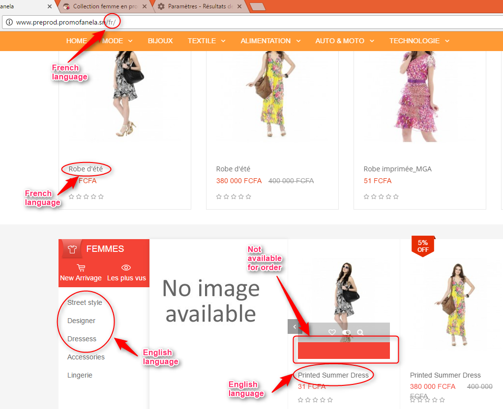

    Posted by: mga91, Mar 21, 2017 at 12:43 (8 year ago)
    The add cart button still appear on Group Category Module. Also the text translation (product name) is not done on Group Category Module. You can verify on the web site. See snapshot for more detail
    Best regards

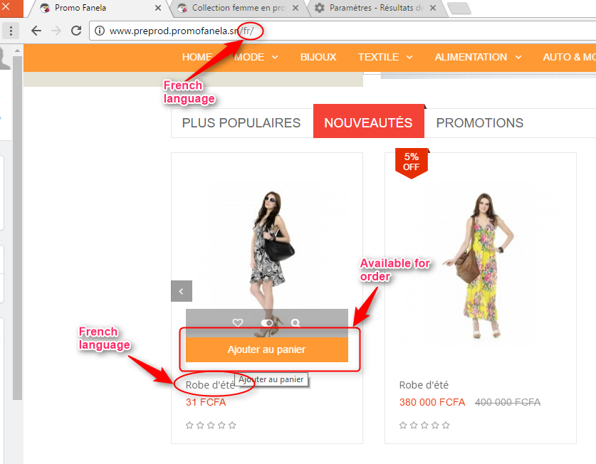

    Posted by: mga91, Mar 22, 2017 at 12:08 (8 year ago)
    Hello YAME
    I seen changes but i still have the same issues
    Actually all product are availabe for order but the add cart button doesn't appear on many product in Group Category Module. And I selected French language but the text appear in english in Group Category Module.
    You can see the snapshots for more details
    Best regards
    Posted by: yame, Mar 23, 2017 at 02:49 (8 year ago)
    Here I send you my explanation in this attached doc. file, pls check it.
    I would like to tell you that I don't see any problem like yours. Pls see my screenshots and you will see that. The texts are changed correctly when I use other languages.
    Or you can clear cache and your browser history to get the best result..
    Hope you can do it well.

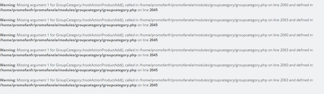

    Posted by: mga91, Mar 30, 2017 at 08:57 (8 year ago)
    Hello YAME
    In our discuss on Skype, you said on your last message:
    "My coder checked your site already and he saw that: When he disabled cache, everything works perfectly. and when he enabled cache, he also got the error. So he would like to give you the recommendation is that you can momentarily disable cache or clear cache to run your site. He will update this bug on the next update version soon."
    I answer you, saying
    Desabling cache is not a good idea, because it improve the performances of web site
    Prestashop said: " Only disable cache if you debugging a theme or a module for PrestaShop. Otherwise, you should leave it enabled"
    And, i had not this issues before you fix the last issue concerning this error (see snapshot)
    Please fix this issue
    Best regards
    Posted by: yame, Mar 30, 2017 at 10:17 (8 year ago)
    After seeing your attachment, my coder can know what he has to do just because the last time he still could not find the reason why and he would like to check on demo site first. Thank you so much for giving this attachment. He guesses that the cache issues is caused by this fixing (after he helped you to fix the problem regarding to disable / enable products). Ok mate, he will do it tomorrow.
